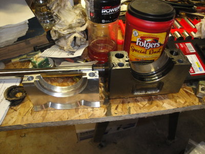

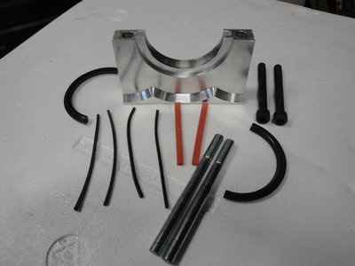

heres my rear main from mancini racing....not in yet....[attachment=1:1dcxj9d2]DSC02386.JPG[/attachment:1dcxj9d2][attachment=0:1dcxj9d2]DSC02387.JPG[/attachment:1dcxj9d2]
22,148
2,358
Those would be for a standard seal retainer with a single side seal :groucho:

well the tranny guy called and the pump gear blew and it was a standard gear....so i told him to replace it with a hardened gear.he said it looked like a bullit proof tranny otherwise....ask about if i should replace the pump and he said it should be good.....i told him to replace that also.....i dont want any trouble down the road

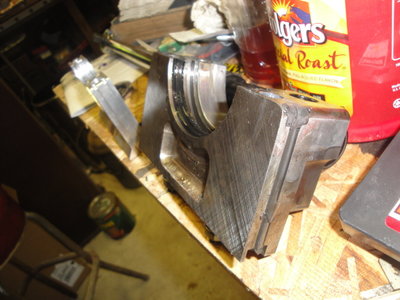

i dropped the oil pan and notice my mancini rear main package wasnt going to work since keith black has the seal built into the #5 main cap....got him on the phone and ones on its way

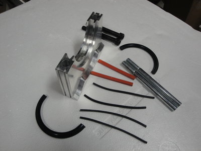

alittle difference[attachment=2:9yjmiho9]DSC02389.JPG[/attachment:9yjmiho9][attachment=1:9yjmiho9]DSC02390.JPG[/attachment:9yjmiho9][attachment=0:9yjmiho9]DSC02391.JPG[/attachment:9yjmiho9]
