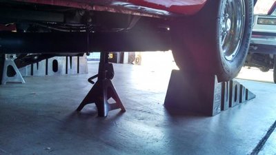

Do you think the car is up high enough to remove the transmission? I plan on dropping it, placing the transmission on cardboard and pulling it out the rear. I have the 3 ton jack stands raised a couple notches, but hesitate on raising them anymore as I feel that will compromise them a bit.
You should be able to get it out like the car sits. But ifyou have clearance issues then just remove the bellhousing and then it should come out easy.

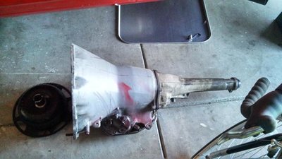

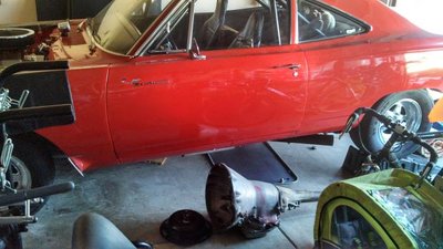

Do you like apples? Well, how do you like these apples?! weeeeeeeeee
Took me all day (8 hours) but I got the transmission out! I couldn't be happier! :)
2 points goes to basketcase for being spot (perfect) on regarding the drive-shaft and flywheel.
