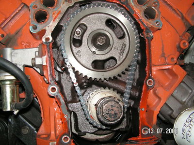

Couple more pictures..........
I see the cam gear mark, is the crank mark above the keyway I cant see it? I havent done a wedge in years but alot of engines the timing mark and keyway are different I think you may be way off. That would be the cause of the piston and valves. Got a better pic of the crank gear?
Your out in the garage pulling the engine when you should be reading this :toetap:
If you go to page 9-55 in the Factory Service Manual, there's a good shot of how the gears should align.
What is a mystery to me is if these gears are off that much, how does the car run at all???
