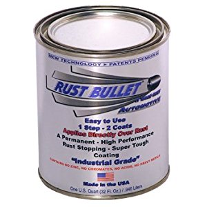

Finished with the rust bullet lastnight. Phone died cause I was listening to music working on the car forever. So went out this morning and snapped a couple pictures before covering her up for the rest of the weekend.

I did it with more then a couple hours of this guy
Then wiped it all clean with some mineral spirits
Then went over it all with 2-3 coats of Rust Bullet
I see on so many restorations they leave out doing the roof interior by just covering it up with the headliner. I'm not a fan of that and I want to get every little bit I can get. I couldn't look at the car knowing I left that part out. Figured now's the best time to get it done so I don't have to worry about ruining my pretty interior when I get it done.
Next on my list is pulling the front window out so I can get that Dash out of the way. Then I'll get started on the floor. Probably gonna rust bullet it then rhino lite it after it dries. But I got a spot or two to patch in the floor. Might just go with a new passenger front floor pan. Maybe not I'll find out. There pretty cheap so I figure I might as well.
