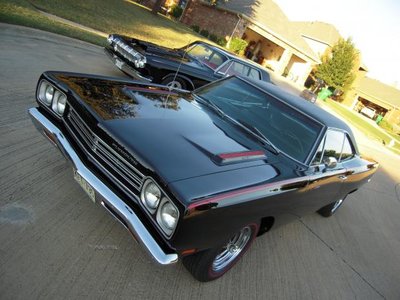

I caught some light that shows how reflective the stripes can be that I put on, I love them! I am glad it came from the factory with the red instead of the white...it really fits the cars attitude better LOL.

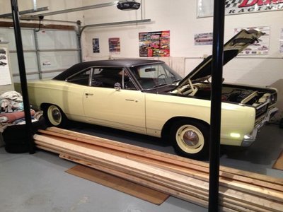

I have an A14 car as well and wish my stripes were red! My car is Y2 Sunfire Yellow and the A14 pkg stripe was white. White with Yellow and Black does not work for me. When the previous owner(s) repainted, it was not added.
Nice looking car you have!

That is a great lookin' car. yeah, the red stripe looks much better on a black car then the white would.
