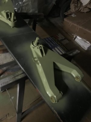

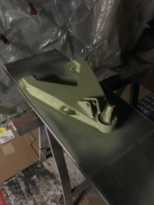

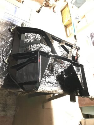

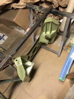

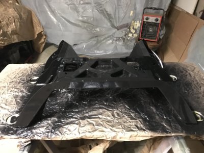

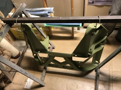

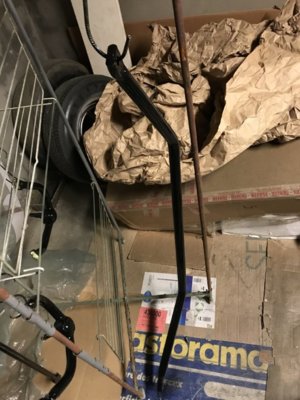

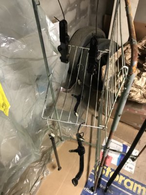

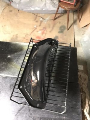

Here are a couple of pics of the front end painted. We forgot t take pictures while it was in primer, but we used the same green epoxy primer that we used on the car and other parts that you have seen during our build.
IMG_9584.JPG IMG_9585.JPG IMG_9586.JPG IMG_9622.JPG IMG_9708.JPG IMG_9709.JPG IMG_9721.JPG IMG_9723.JPG IMG_9724.JPG IMG_9725.JPG

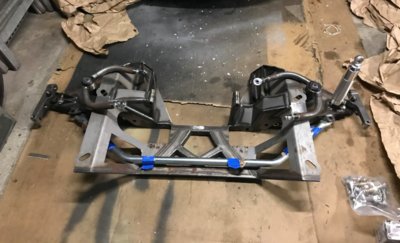

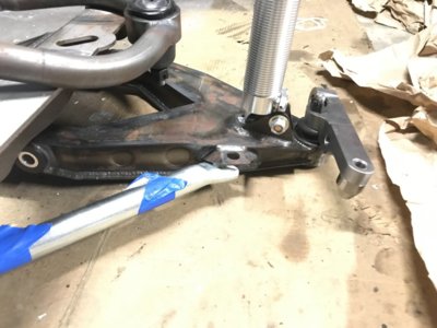

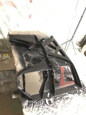

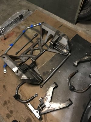

Really nice job on the K member. Is that the hotchkis member. Looks really beefy. This was what you where waiting on being shipped form the state's?

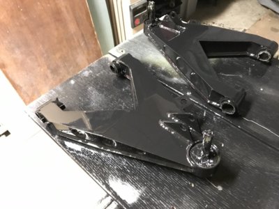

Sixtynine_Bird
Nov 30, 2014
654
125
France
this is absolutely what I was waiting on being shipped from the states since February, gad it finally arrived.
This is not the hotchkiss member (didn't know that they were doing one), this is the Transformer Kmember from MagnumForce. Those LCA's are huge! Was really impressed by that. Welds looked good, and yes it looks like it is beefy.
Can't wait to have it all assembled. Only once thing was missing, the bushing for the rack and pinion. Called them and they shipped it to my address, now I am waiting for these to arrive.
Now we will let it dry for at least a week, then start the assembly of the LCA's the rack&pinion once we received the bushings. Then once the car is home will do a mock assembly on the car without the engine to see if everything goes well and finally we will see the bird back on all 4! And will check the stance! Can't wait for that too.
