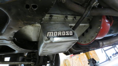

Okay, for anyone still interested I think we found the answer. the first picture is what we started with. this pan has been on the car for about 5 years now. it uses an internal pickup that did have to be clearance for the stroked connecting rods.

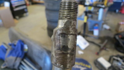

after removing the pan and the pickup tube I think Ill let the picture tell the story
THe pan has been changed to a milodon road race type pan with the wings on the side. this creates more ground clearance, and still holds about 7 quarts of oil. This however requires an oil pump set up for external feed. this oil pump happens to be a little thicker than the stock one which meant off to the store for more bolts. longer. all stuff installed and tested with the drill and now have 63 lbs pressure just on the drill with cold, fairly heavy oil. 15-40. now just have to put the distributer back in and reset timing and should be good to go.

Just what I said also it's a crack. :lol: Put that new pick up tube on their and she should work fine. Good luck Quickbird.
