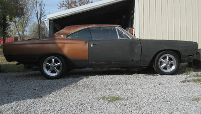

I know there is a lot of nay saying about larger wheels right now, but here is what I bought. Tires will be here this week. :stuckup:

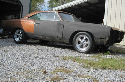

Mounted my tires today by hand!(which sucks) Decided to try them on my Parts car since I don't have any suspension under my Road Runner!
that looks purty good actually.stlll like a llttle more sldewall.
and that;s a parts car? lt looks pretty decent.

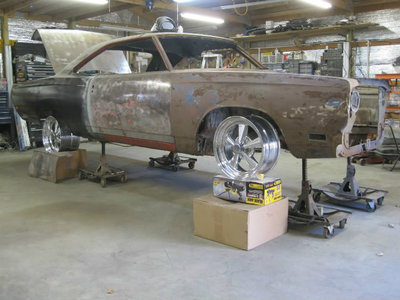

Over 10" wide in the rear of tread on the ground, and just under 10" on the front. There is almost 2" in between the leaf spring and the tire, and about 1 1/2 room in between the quarter and the tire. Pretty happy with the fit. Won't need air shocks on this one, lol :banana:

It looks really good. I think the look of the cragars dispells the rap star look. I dont like big wheels usally because people have really shippy taste in wheels. You have a good look going. Dont tell Ray okay?

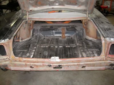

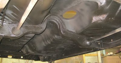

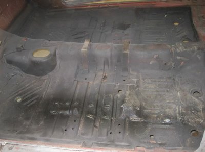

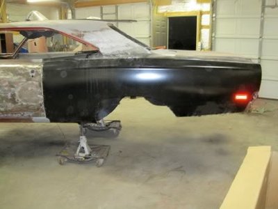

It doesn't look like much progress has been made, but I have still bee welding under the car, inside wheel houses, and also added those us tool sub frame connectors. I really like them. They weld to the floor, and the front and rear uni-bodies, and it does make the car pretty strong. I even tried jacking the car up[ in the very rear under the frame and the door gaps do not budge. I did the same before I added them and the gaps close up a little bit. I am not painting the bottom of the car because this is just going to be a driver type car. So I am just under coating it all. :yesnod:
Converting the car to a 4 speed and added the new AMD 4 speed hump!
Welded in new front floor pans.
New AMD full trunk pan and extensions.

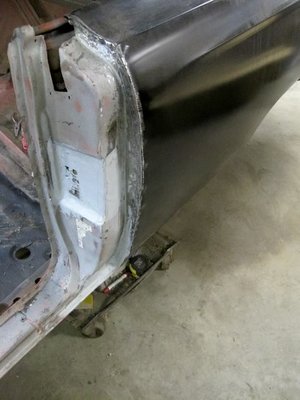

Had to buy a reinforcement patch for the striker area, worked really nice.
Still some work to do in the door jam to quarter area, but it is coming along.
