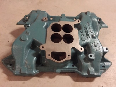

Should have an original intake sometime next week. It's been bead blasted inside and out, no cracks, and in good condition.

But the OE intake manifold arrived today.

Dropped off the intake manifold at the shop after work this afternoon and the guy there was surprised I was able to find one in such good shape. He also told me he got an update from the engine builder.... The 2 Pistons weren't burned, they were cracked. It had previously been bored 30 over and is now 40 over. He was able to locate new pistons with no problem. Still waiting for the cam to come in. The one that was in it was just a hair larger than stock and will be replaced. I also went ahead and had him go through the heads with new seats, etc.

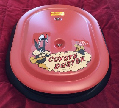

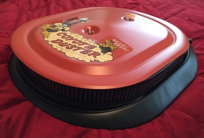

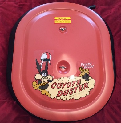

Air cleaner to go atop the freshly rebuilt engine. I was able to get the air bubbles out with a heat gun and plastic bondo paddle. I went with the K&N filter as my RR is going to get the classic air A/C once I get her back, so it's not all original anyways.
I'm antsy to get mine out. in the 60s today, supposed to rain tonight, so they will get rid of the road salt. but gotta work two twelves, then more snow on my days off, more salt...vicious cycle.

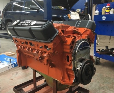

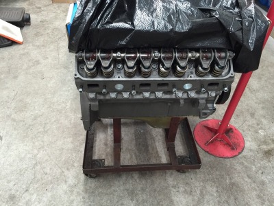

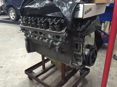

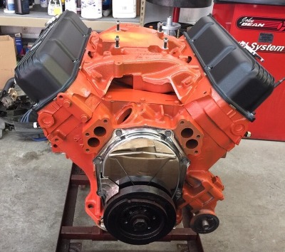

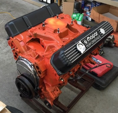

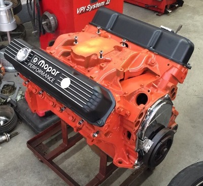

Dropped off the air cleaner at the shop yesterday afternoon and saw the engine in person. Richard, shop owner, is almost as excited as I am to get the engine back in and top it off with this air cleaner. Took a couple pics of the engine while there.
