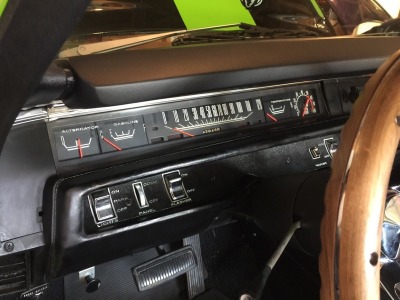

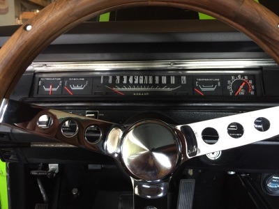

Just finished up with the gauges, replaced the cracked faceplate ($20 eBay score), and new steering wheel. Hindsight... wish I would have taken a couple before pics as I only have the ones when I first got her. It looks so much better with the "Flava-Flav" style tach off the top of the steering column and on the dash, where it belongs.
Before:
Now:
301
lookin good :thumbsup: I've had two '69s with the factory tach, and neither worked. this one had a Sun tach in the trunk when I got it, and I put it back on the column. adds to the Day Two look I like.

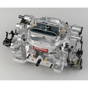

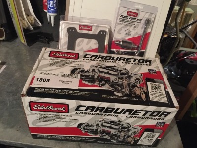

I'm done with the Holley carb. Even after being rebuilt, it's leaking and causing the RR to not want to crank or run. I just ordered an Edlebrock 1805 650 cfm. I went with the manual choke vs electric. Summit had it, new gaskets and fuel rail in stock. Now I just have to clean up everything and get the new carb in.
